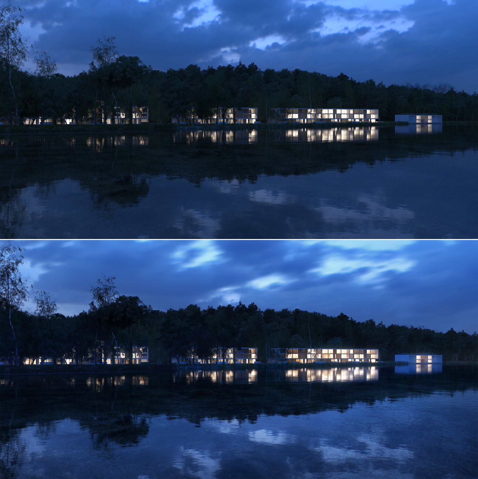

For the night shot I blurred a bit the sky and the reflections on the water, simulating a long exposure. Tuned the contrast a bit and applied a slight glow to the highlights.
I also applied some subtle mist effect using the z-depth pass.
raw_post_night
