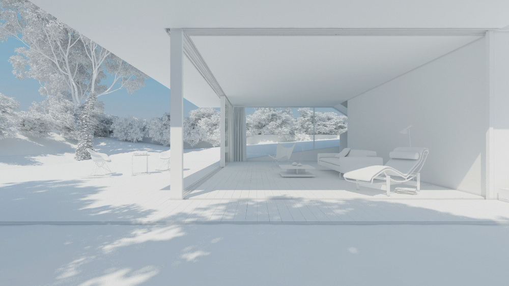

In order to create this mood of interactive indoors-outdoors spaces we activated different areas with different ways. We wanted real shadows of the trees and reflections in the water. Then these shadows that were penetrating the living room should be only in some depth.The trees should also let the light pass in the lawn. So in this case we had to use 3d trees and not emphasize in the garden and foliage as such.
02_KBC_more detailed model
In this picture the detailing in the house was extensive but again in a manner that wouldn’t overtake the simplicity of the garden.
03_KBC_detail

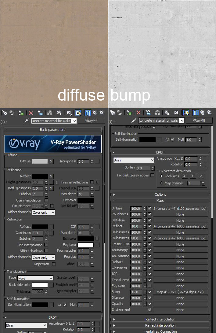

Textures and Settings
These are the parameters for the basic textures I used.
Simple texturing with wood floor and concrete walls and ceiling. The wood plunks were created with the amazing `floor generator` plugin.
04_KBC_ceiling concrete
05_KBC_concrete walls
06_KBC_Wood
