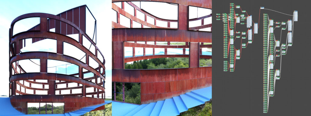

At this `Work process` I`d like to explain how I created material of corten steel. At the very beginning I was thinking to create nice material with Substance Painter, but it wasn`t a really good decision because in that case I can create one-project-material and I want to make something more multipurpose, material which I can use in future projects.
I found nice corten texture and divide it on few smaller ones to get randomness on my corten panels. So my basic material it`s quite complicated blend material with few levels of dirt and BW masks to looks as realistic as possible, which later I copied few times with different numbers on AO.
I made separate materials for different levels of panels:
1. Wet panels under windows with a different intensity of AO and glossiness.
2. Dry panels from sunny side.
3. Top panels with dirt only on edges.
4. Lower panels with ground dirt.
5. Vertical panels.
